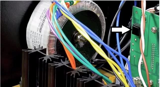

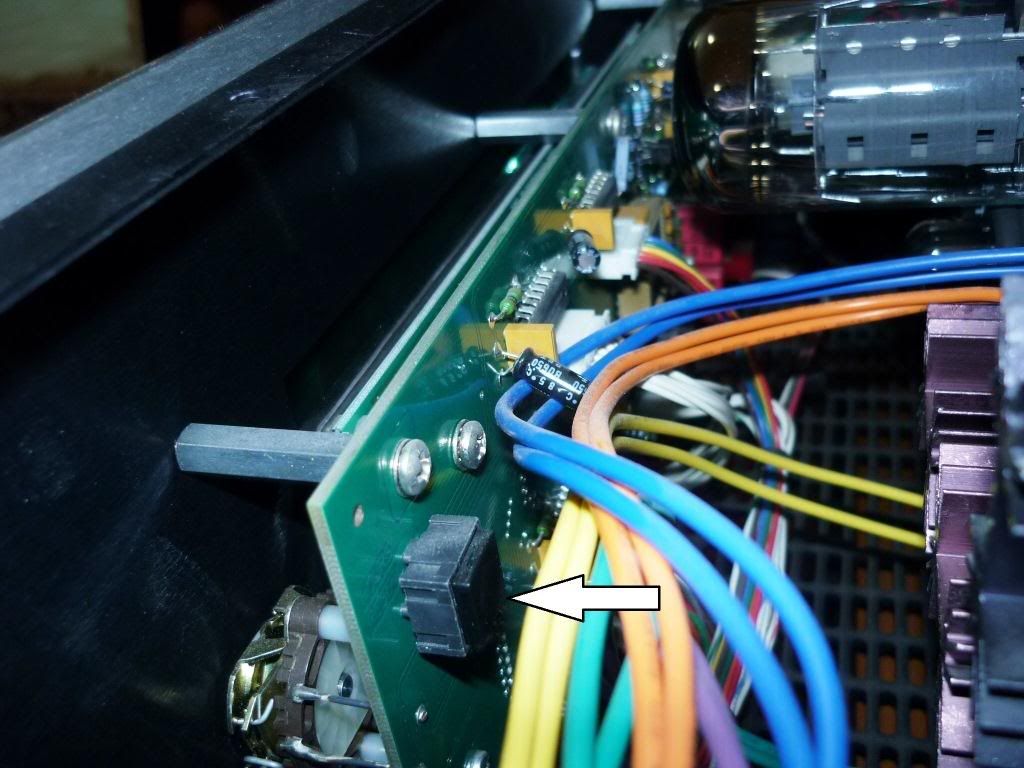

    That button is located on the upper right corner of the display circuit located beside the front panel...
    Here is the AUDIO RESEARCH REF5 TUBES HOURS RESET to ZERO BUTTON...
    and here the AUDIO RESEARCH REF3 TUBES HOURS RESET to ZERO BUTTON...
