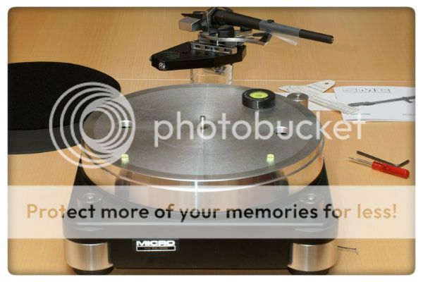

    Hello ACA friends,
    it took a long time, to finish the plinth-stabilizer-project, but it certainly pays off! The bass foundation is much more accurate and taut and the high frequencies sound more exact. So I’m very happy with my heavy turntable. Thank you for your support, Kyriakos!
    The photo shows how I mounted the heavy iron plate without removing the platter. That was necessary, because after 30 years the platter was inseparable connected with its bearing and I didn’t want to use any “heavy tools” to remove it.
    Furthermore I exchanged my old SME 3009 (improved) tone arm for a very nice SME 309 magnesium type. All together it pushed my system to different league.
    More pictures can be found on my new homepage
    Soon I will report about my special SME-mounting-modification.
    Bye for now,
    Lothar.

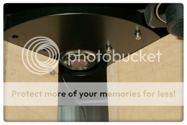

    Mounting the new SME 309.
