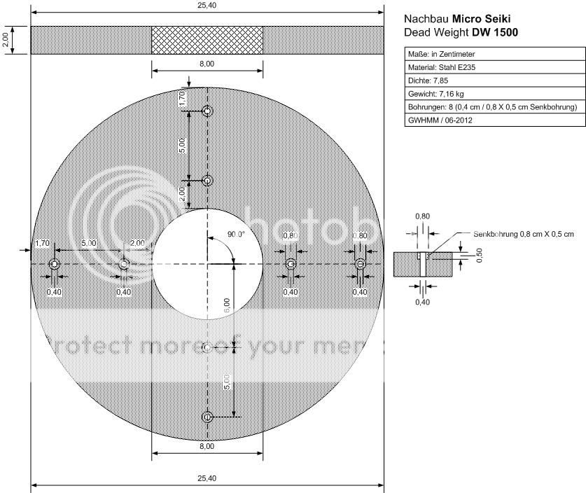

Meanwhile I decided to build the dead weight from ordinary EN 1025 steel (density 7850 kg/m³). After measuring the plinth I used lightly different dimensions in comparison to Kyriakos one. So I will gain a 7,1 kilogram steel plate. This considers the “missing” motor-unit and additional the heavy brass mounting plate for my new SME 309 tone arm.
Today I received the rough machined steel plate taken from round bar steel. Now my son has to finish the weight on metal working lathe.

Hi Kyriakos,
unfortunately I keep busy in job-related works and the stabilizer has to wait for one or two weeks more. So I can only show you a little preview.
…will be continued.

Hi Lothar
Very nice mechanical drawing with details.
I would love to have it if you don’t mind.

Toptubes wrote: Hi Lothar Very nice mechanical drawing with details. I would love to have it if you don’t mind.
Hi Kyriakos,
gladly I will send it by email.

Hi friends,
it took a long time to machine the iron plate, but now it’s ready. Before the necessary powder coating, I tried to mount the plate temporary to make sure that the bore holes are at the right place. I had to do that without removing the aluminum platter, because that thing seems irremovable after 30 years and I didn’t want to take the risk of damaging the bearing.
