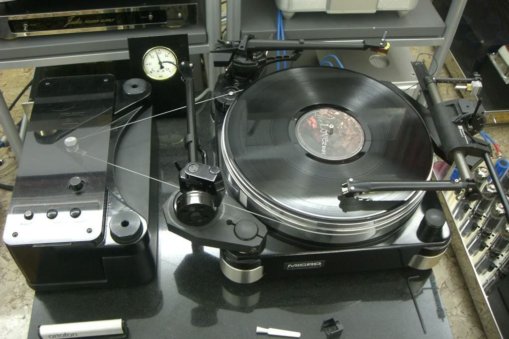

    What Dirk told you is right. I have a Micro RX 1500 with the vacum option and I made a copy of the RW-1500 plinth stabilizer since the original is hard to find and if you do the price is more than $1000.
    I actually found the dimentions of the original and I made one out of soft iron.
    9  13 Feb 2012
    If you need to make a RW-1500 dead weight then here are the dimensions:
    Overall diameter : 255mm
    Center opening diameter : 77mm
    Thickness : 19mm
    Axial fixing holes : first 2.2cm second 5cm (measurements from the edge of the central hole of the two serial holes for the fixing bolts)
    Actually there are 8 fixing holes in total but the rest of the serial holes are 90˚appart from the given measurements (if you see the picture of the part then you get the idea)
    Use soft iron is the best sounding metal I used. I mede one out of bronze and one out of steel but the soft iron was the best by far.
    The original one is made from cast iron.
    For any more questions I’m available any time.
    Best regards
    Kyriakos
